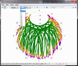

RTKPLOT also support multiple code but it's not too much talk.
Also supports instantiation of SNR Graduate color I like can be seen: York supplement. You also feel too much colors, with an emphasis on compatibility with versions up to now. Incidentally, entirely rewrite the internal structure of the conversion is also RINEX to RINEX convrnx.c. Because it can generate a simulated real-time stream from RINEX and easily handled by a virtual stream RINEX. Lest they should not tamper with the internal structures pretty That said, I may not be developed to converge. In addition, the release of 2.4.2 it is likely that delayed until after next spring, please contact us directly with a necessary if beta version under development. (PS 11:34)

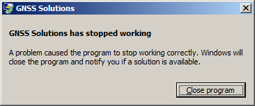

ich habe jetzt mit der neuen GNSS Solutions 3.80.4 etwas experimentiert. Leider bekomme ich immer noch sehr oft folgende Fehlermeldung und das Programm stürzt ab. Die Projektdatei ist danach leider oft leer.
Ist das bei Dir auch so. Ich habe es auf einem englischen Windows7/64 installiert.
