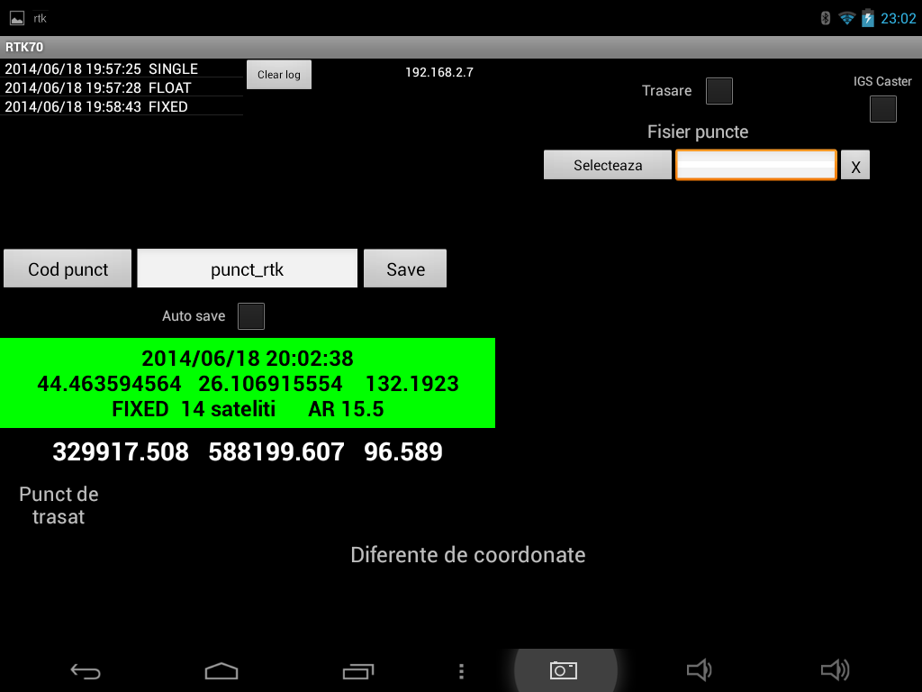

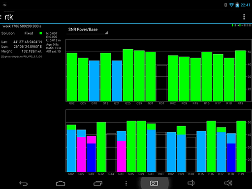

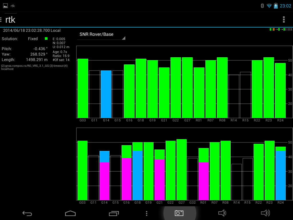

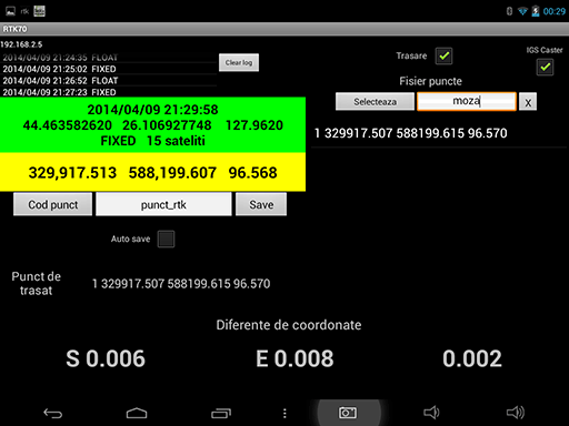

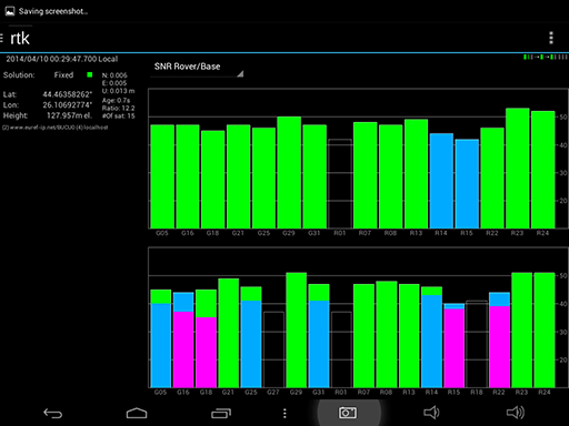

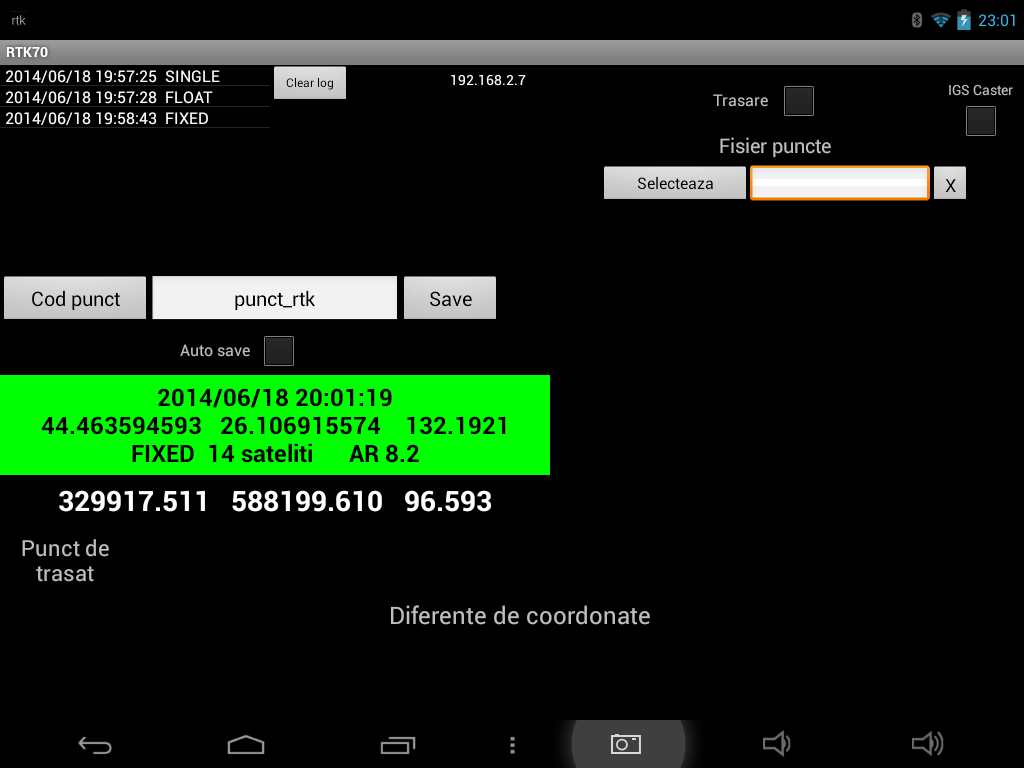

Beitrag von Hagen.Felix » 21.06.2014 - 12:00
Anbei noch ein paar aktuelle Screenshots vom Android-Tablet des Kollegen ...
"Hi Hagen,
I attached some screenshots for you to see how fast acts the NVS.
I think that 1-2 mins/1.5km baseline to get a fix it's a very good time for a L1 receiver.
Cheers,
Dinu"
